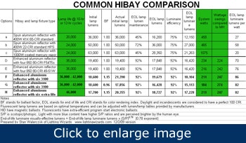

Although many lighting retrofit contractors, hibay manufacturers and others push high-output, 5/8-inch diameter fluorescent T5HO lamps, you can see in Table 1 that high-performance, 1-inch diameter T8s are much more efficacious, the lighting industry term for efficient. The green columns are the most important.
If you want to get technical, end-of-life (EOL) lumens are much more important than initial or mean lumens, because EOL is the worst case. The higher the scotopic/photopic (S/P) ratio, the more blue content the light has and the brighter the light to the human eye. Visually-effective lumens include effects of S/P ratios. The listed fluorescent lamps are 850s, which are rated at 5,000° Kelvin, a value high enough to provide a substantial blue content without making the light look bluish.
Table 1. Focusing on the data in the green columns is the key to choosing the most efficient plant lighting systems.
Because T5HOs have peak light output at an ambient temperature of 95°F and T8s have peak light output at 77°F, and because output decreases significantly with deviations from optimum ambient temperatures, it’s good to have a cushion. Of the three T8 options shown, option G isn’t recommended unless the space is heated and air-conditioned or excessively overlit. Just because T5HOs have peak light output at a higher temperature than T8s doesn’t necessarily mean T5HOs are better in hot conditions, because T8s can often dissipate heat better in well thermally designed fixtures.
Six high-performance replacement T8 lamps cost less than four T5HO lamps, especially the 49-watt to 51-watt models. T8 lamps also last longer, especially the extra-long life versions. Plus, these are the same T8s that can be used in offices and other parts of the building, which can help minimize lamp and ballast inventories. If you decide to go with T8 hibays, it’s important to get the correct lamps, ballasts and fixtures.
There are two good choices for 5,000°K T8 lamps. One is lamps with the highest lumen output included in the Consortium of Energy Efficiency’s 32-watt high-performance listing at www.cee1.org. Many rebate programs mandate using these approved lamps. The other good choice is extra-long-life lamps, which produce fewer lumens, but last longer. Sometimes an extra 6,000-hr rating is more important than more lumens. The big three lamp manufacturers offer extra-long-life T8s. Some rebate programs might not provide rebates with extra-long-life T8s. The 4,100°K T8s can be used, but they’re not as bright as 5,000°K equivalents.
