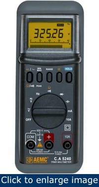

Figure 1. The hand-held digital multimeter is the workhorse of the circuit testing tools available.
Digital multimeter
Digital multimeters (Figure 1) are the most common type of electrical test equipment and are the workhorses for electrical testing. Applications for multimeters are numerous and include testing voltages at both power and control levels, measuring the current to various loads, checking the resistance of motor and transformer windings and other components, and testing continuity of relay or switch contacts and wiring.
Almost every multimeter measures AC and DC voltage and current, and resistance. Voltage measurements generally range from millivolts to 1,000 volts. Current ranges generally run from milliamps to as much as 10 amps. Resistance measurements typically are from less than one ohm to tens of megohms. Many models have additional functions such as continuity buzzers, temperature, capacitance, frequency and diode testing. More advanced models include peak hold, inrush current, max/min recording, data logging and PC communication for setup and data storage.
Meters that measure true RMS (TRMS) values are more accurate than average-responding meters when waveforms contain harmonics, such as the voltages and currents in motor drives and power supplies.

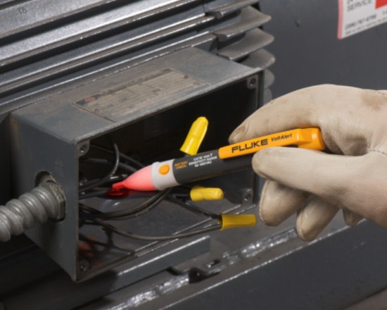

Non-contact voltage detector
Figure 2. The non-contact tester indicates whether a circuit or component is deenergized.
These instruments are simple and effective for quickly determining whether voltage is present on a circuit or in a panel (Figure 2). However, you must verify that they’re working properly if you want to rely on them for confirming voltage absence (see sidebar, “Safety takes three steps”). A follow-up test with a multimeter is recommended to confirm that conductors are deenergized before performing work on the circuit. Various models use lights, buzzers or both as the indicating signal.

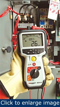

Insulation tester/megohmmeter
Although multimeters measure resistance, they’re not capable of making the very high resistance measurements needed for testing insulation on components such as bus bars, panels, motors and transformers. For this task you need an instrument that measures tens or hundreds of gigohms (1 gigohm = 1,000 megohms) at test voltages from 500 to several thousand volts (Figure 5). Insulation testers apply the test voltage between the conductors or windings and the metal frame of the equipment under test, measure the very small current that flows through the insulation and display the result as resistance.
Figure 5. The insulation tester monitors the current flowing through the insulation between a conductor and its environment.
Modern digital testers automatically run insulation tests — dielectric absorption ratio, polarization index, step voltage and dielectric discharge. These non-destructive tests involve calculations based on changes in the insulation resistance during a measurement period of several minutes. When performed regularly, megohm tests can indicate insulation deterioration long before it becomes a problem.
