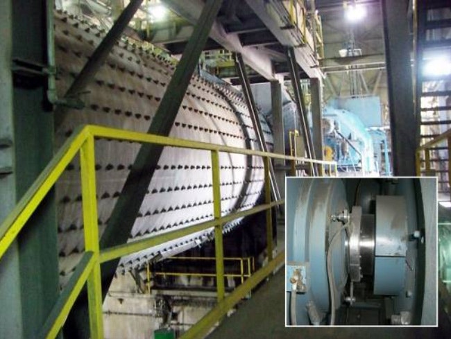

It seemed as though nothing could stop the squealing. Not that Monarch Cement’s huge ball mill wasn’t already loud. Powered by a 5,000-hp motor, it pulverizes 100 tons of clinker — a burned mixture of limestone and shale — per hour. But the squealing wasn’t what Randy Riebel wanted to hear. As electrical supervisor at Monarch’s plant in Humboldt, Kansas, he knew the noise meant the motor’s bearings were going again.
In fact, the sound of chronic bearing damage was all too familiar at the plant, which can produce 1.3 million tons of cement a year. Since 2001, when the ball mill was new, its motor bearings had to be replaced three times.
“We kept greasing those bearings, but they kept on squealing,” Riebel recalls. “We knew that if we waited too long, the bearing race walls would become fluted like they had in the past, and we weren’t looking forward to another replacement because of all the expense and downtime. It takes at least 10 days to pull that motor. It’s a major production. Sometimes we have to hire help, rent a hoist to put it on a truck and take it away to be rebuilt. So, this time, in the summer of 2009, I decided to try something else.”
This is the ball mill on which the first two grounding rings were installed at the Monarch Cement Company plant. The 5,000-hp motor bearings failed regularly until an AEGIS iPRO Bearing Protection Ring (inset) at each end of the motor diverted damaging voltages. These on-site retrofits were accomplished without the need to decouple the motor from the mill, thanks to the use of a split-ring version of the iPRO.

Riebel had been discussing electrical bearing damage with Scott Wilkins, manager of motor shop operations for Independent Electric Machinery (IEMCO), a local motor and equipment repair shop. Wilkins recommended the iPro, and Riebel had IEMCO install two on the ball mill motor. EST recommends installing an iPro in the drive end and insulation on the non-drive end of most large motors. For some large motors, especially those that don’t have insulation designed into them or where insulation can’t be installed easily, EST recommends installing iPro rings at both ends of the rotor shaft.
Riebel and Wilkins chose the iPro split-ring model, which is designed to facilitate field retrofits. The mating halves install around the motor shaft without the need to decouple the motor from the mill.
