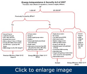

Depending on the type and size, 1-500 hp motors now must meet minimum, nominal, full-load efficiency ratings. What this means is that standard efficiency motors that many plants might be running will no longer be available and ultimately will need to be replaced with NEMA Premium Efficiency motors. But plant maintenance personnel still can use the standard efficiency motors.
