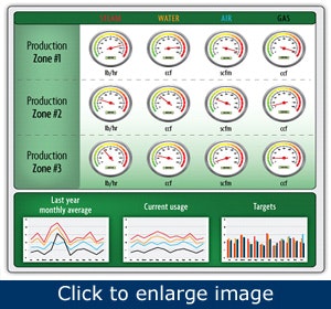

So, own it and challenge your team by tracking energy consumption trends. Many maintenance organizations employed and communicated process key performance indicators for years and they’ve become a valuable tool in managing complicated processes. Communicating energy consumption trends should receive the same visibility. Build a continuously updated dashboard (Figure 1) to communicate raw material and energy consumption and challenge your team to optimize their part of the energy conservation equation. In effect, empower your team with the information needed to succeed and help facilitate ownership of the process.
Figure 1. This dashboard display can spur a maintenance team to achieve significant energy reductions.
