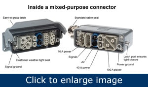

During assembly, connectorization can cut initial wiring costs by reducing or eliminating the need for rigid or semi-rigid conduit. A primary reason for armored wiring is to reduce the chance of severing wires in a cable, which in point-to-point wiring could require a large amount of time to repair or replace. Connectorized wiring allows a cable section to be quickly replaced by unplugging it and plugging in a new section. For a similar reason, it cuts debugging and testing costs. By using pre-wired and tested cable assemblies, connectorization can improve manufacturing efficiencies and logistics by allowing staged panel assembly. With everything connected by plugs, disassembly for shipment involves unplugging the different parts. There’s no need to disconnect I/O, power, pneumatics and signal cables separately when hybrid connectors are used (Figure 1).
Figure 1. Example of a multipurpose hybrid connector for pre-assembled cabling.
