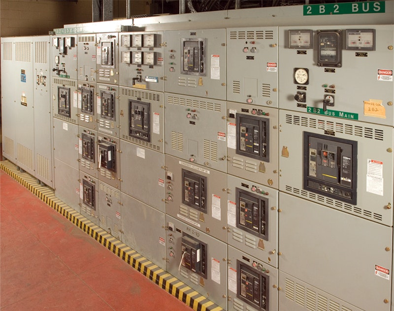

Figure 2. Even with proactive maintenance, circuit breakers can be upgraded, while the switchgear structure, conduits, cabling and footprint are left intact.

    Even with annual maintenance, however, power circuit breakers may need additional upkeep or upgrades (Figure 2). Factors to consider include the operating environment, availability of spare parts, reliability, and the cost of ongoing maintenance. There may also be the need to increase the switchgear’s fault or continuous current rating, or the desire to upgrade technology. As a result, facility managers are often faced with the choice of maintaining aging or obsolete equipment or replacing it with a new switchgear lineup to take advantage of current technology (Figure 3).
