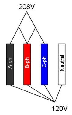

Figure 1. Voltage classes obtain their values by the potential that exists between each phase and between each phase and neutral and/or ground. The same principles apply to other voltage class systems

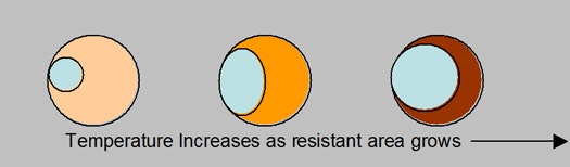

Figure 2. The cross-section view of a conductor under normal load conditions increases in degrees of resistant. As resistant area increases, conductive pathway area decreases and the amount of heat will rise.
