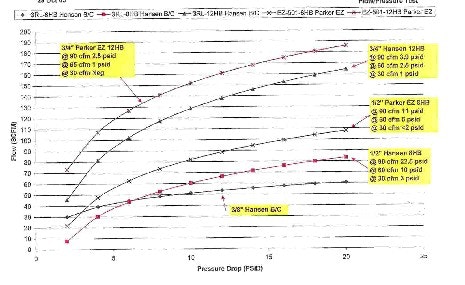

Seek tested performance curves
Don’t assume that because couplers appear similar the performance is similar. Review the performance curves or, even better, measure the pressure loss at specific flows. On a recent audit to help select the proper disconnect for a major tool operation, we tested the pressure drop on two specific types of quick disconnect  — a lock-ring coupler with a ball-check nipple versus an exhaust-type coupler with a standard nipple. Both had 1 1/4-inch diameter coupler bodies and ports sizes of 3/8-inch, 1/2-inch and 3/4-inch The 3/8-inch nipple on the lock-ring type coupler didn’t have a ball check to shut off the air. The 1/2-inch and 3/4-inch units did. The exhaust-type couplers had the full shutoff and exhaust to allow disconnect at zero pressure.
Figures 1, 2 and 3 are the three sets of performance curves that reflect the measured pressured drop of each quick disconnect at various flows and inlet pressures. The results will probably vary by manufacturer. The key is to optimize performance by investigating.
Figure 1. These measured performance characteristics of several quick disconnects show flow as a function of pressure drop. Click to enlarge.
We found a significant pressure drop difference between the 1/2-inch quick disconnects. The exhaust coupler could work in an acceptable manner from less than 30 cfm to as much as 60 cfm and still maintain 100 psig inlet with 80 psig to the tool or 90 psig inlet with 70 psig to the tool.
  • The 1/2-inch lock ring/ball check nipple quick disconnect appears acceptable at 30 cfm but probably won’t be acceptable at 60 cfm.
  • The 3/4-inch quick disconnects are closer in performance, but the lock ring/ball check type introduces 30% to 40% more pressure drop.
  • The 3/8-inch lock ring/ball check nipple quick disconnect tested didn’t have the ball check valve in the nipple, which accounts for its lower pressure drop compared to the 1/2-inch lock ring coupler, which did. This, of course, means that the safety feature to control potential hose whip isn’t incorporated into the 3/8-inch lock ring set.
This test data isn’t intended to recommend one disconnect over another. For the particular application investigated, with many grinders and impact tools using between 60 scfm and 90 scfm, the exhaust-type quick disconnect exhibited the best overall performance and economics. On a different application, testing may well dictate another choice. The important point is to select quick disconnects, hose and pipe with diligence and attention to detail. Although disconnects are a relatively inexpensive piece of equipment, if misapplied, they can be costly.
