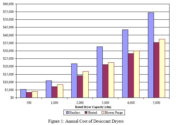

These equations can be used with dryer manufacturer specifications to determine the energy cost to operate the unit. The equations, with generalized manufacturer dryer specifications, were used to develop Figure 1, which summarizes the energy cost associated with the operation of heatless, heated and blower purge desiccant dryers.
Figure 1: Annual operating cost of desiccant dryers. Data assumes 8,760 operating hours per year, $0.05/kWh utility rate, compressor generation efficiency of 4.5 cfm/hp and compressed air and ambient air temperature of 100°F.
The heatless desiccant dryer is the most expensive type to operate at any capacity, while the heated type is the least expensive to operate at any capacity. The magnitude of difference between the heated and blower purge type is fairly small, indicating that users should base any decisions between these two types on other factors (initial cost, maintenance costs, excess capacity for purge air, etc.)
