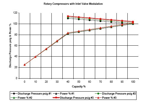

Typically, the first compressor would have a discharge pressure control range of 100 psig to 110 psig, with full capacity at 100 psig and modulation down to 40% capacity at 100 psig, at which point it unloads.
If all three units had the same discharge pressure control range, they would simultaneously reduce capacity at the same rate, which is inefficient operation (Figure 1).
Often, the settings are staggered within a limited range to avoid a high overall pressure range. Ideally, the pressure settings would be reduced. However, if 100 psig is the minimum desired operating pressure, let’s arrange compressor 1 to operate in the range from 100 psig to 110 psig, compressor 2 from 102 psig to 112 psig and compressor 3 from 104 psig to 114 psig. Assume that the compressors and their drive motors are capable of operating at these upper pressure ranges (Figure 2).
As demand decreases and system pressure rises from 100 psig to 102 psig, compressor 1 modulates to about 88% capacity and a power requirement of 96%. Compressors 2 and 3 remain at 100% capacity and 101% power because of the increased pressure. This gives a total capacity of 96% and a total power requirement of 99.3%. At this point, compressor 2 is on the verge of modulating.
As demand further decreases, pressure will continue to rise. Compressor 1 will modulate more deeply and compressor 2 now starts to modulate. At 104 psig, compressor 1 is at 76% capacity and 92.8% power, while compressor 2 is at 88% capacity and 94.3% power. Just before compressor 3 starts to modulate, it will be at 100% capacity and at 102% power because of the increased pressure. Now, the total compressor capacity is 88% and total compressor power requirement is 96.4%.
If demand continues to fall and discharge pressure increases to 106 psig, compressor 1 goes to 64% capacity and 86.2% power, while compressor 2 is at 76% capacity and 92% power. Compressor 3 has modulated to 82% capacity and 96.5% power. This represents a total compressor capacity of 74% and a total compressor power of 91.6%.
Immediately before the discharge pressure reaches 110 psig, compressor 1 will be at 40% capacity and 82% power, compressor 2 will be at 52% capacity and 86.5% power, while compressor 3 will be at 64% capacity and 92.8% power. This yields a total compressor capacity of 52% with a total power requirement of 87.1%. Obviously this isn’t an efficient, or recommended, means of operation.
If demand continues to decline, compressor 1 unloads, reducing the total compressor capacity from 60% to the combined capacity of compressors 2 and 3, or 46.7%. This could cause compressor 2 and compressor 3 to modulate less if the system capacity requirement is higher than 46.7%.
