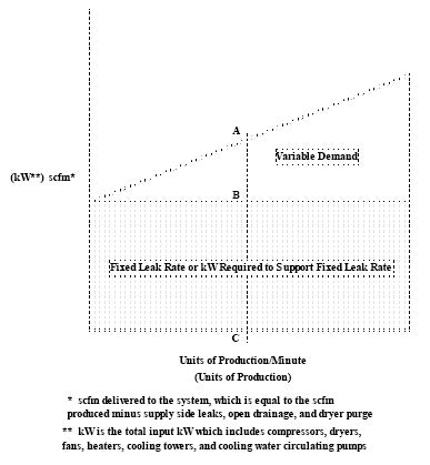

Demand-side and system performance rates
The problem with basing rebates on demand-side or system efficiencies is that these variables are meaningless unless one compares periods with identical production rates. The reason is that plants have a relatively fixed leak rate. We can resolve this problem by using performance rates rather than efficiencies (Figure 1).
First, conduct a low-load test to measure the fixed demand (B) and the kW (B) needed to support it. The fixed demand is the demand that occurs during periods of no production. Knowing fixed demand and the kW that supports it allows you to calculate the demand-side and system performance rates.
For example, the demand-side performance rate is equal to:
((A – B)*(T))/(C)
where T = time (in minutes)
A = the average flow rate (scfm) into the system during T minutes
B = the average fixed demand (scfm)
C = the number of units of production produced during T minutes
The system performance rate is equal to (A – B)/(C)
where A = the average kW during T minutes
B = kW supporting the fixed demand
The demand-side performance rate will decrease as you eliminate open drainage, artificial demand and inappropriate uses, and repair the leaks. In addition to decreasing along with demand-side improvements, the system performance rate also improves with supply-side improvements such as installing automation or new, more efficient compressors and dryers. Therefore, the system performance rate is the best indicator for a rebate program administrator to use. The supply-side efficiency and the demand-side performance rate determine where the improvements occurred.
Measure your fixed demand rate and its associated kW at least annually and again after each major leak repair effort. If your trim compressor constitutes more than half the online kW, you’d need to compare system performance rates during periods with the same production rates because a trim compressor’s efficiency is a function of its average load.
While it’s true that using a performance rate masks the magnitude of the leak rate, it also provides you with a tool that lets you know whether your efforts are paying off. The value of measuring the fixed demand and tracking efficiency and performance rates lies in the fact that you’ll know where to look for problems. For example, if system performance is deteriorating, look at the supply-side efficiency and the demand-side performance rate to determine on which side the problem lies. If both values have increased, then the problem is most likely caused by an increase in the fixed demand. You can confirm this by conducting a low-load test. Conducting a demand-side survey during the low-load test allows you to separate the fixed demand into production uses and leaks.
