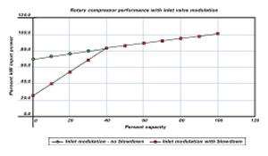

Modulating control
Modulating (inlet throttling) control is found on rotary screw and centrifugal compressors.  Modulation allows for stepless output control to meet varying demand. At less than full capacity, the inlet valve throttles back, thereby matching system demand by restricting airflow into the compressor. Because the inlet valve remains wide open (fully loaded) up to the modulation set point, the minimum allowable system pressure and the control set point can be the same.
Rotary screw. On a rotary screw compressor, modulation is an inefficient way to control capacity, because it affects the inlet pressure of air being compressed. Throttling the inlet valve creates  a vacuum at the rotor’s inlet. This reduces the absolute pressure at the start of the compression cycle, thereby increasing the overall compression ratio. Brake hp is dependent on the volume of air compressed and the compression ratio.
As compression ratios increase, so does bhp. For example, running at 100% capacity, air pressure at the rotor inlet is 0 psig, the same as ambient (assume 14.7 psia). With a 100 psig discharge pressure, the overall compression ratio is 7.8:1. When system demand decreases, the inlet valve throttles back, restricting flow. This results in a lower absolute pressure at the rotor inlet.
Figure 2.
At 65% flow, hp requirements are reduced. However, because inlet pressure at the rotors is reduced to approximately 9.5 psia, more work is required to raise inlet pressure to its final discharge pressure of 100 psig (114.7 psia). As a result, the overall compression ratio is now 12:1. Although less air is being compressed, which reduces the power required, the higher pressure ratio increases input power. As a result, a modulating inlet controlled compressor operating at only 65% of full-flow capacity still requires 91% of full-load power (Figure 2).
