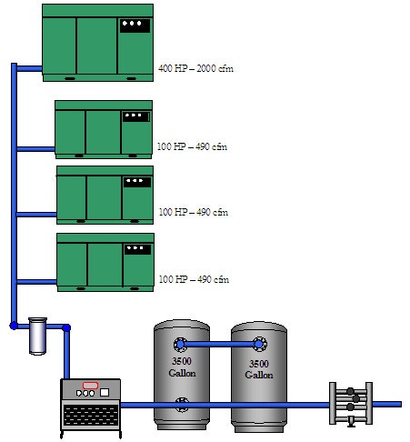

This large central air management system didn’t work. The 400-hp unit was converted from variable-displacement control to two-step (load/no load) control and pressure fell to the cut-in point. A 100-hp unit came online and added 490 acfm. The pressure in the discharge line then rises to the 400-hp unload point (storage tank, single point connection). The 400-hp unit unloads and removes 1,900 acfm from system and the pressure falls quickly. Two more 100-hp units turn on (adding 980 acfm) and the 400-hp partially loaded unit starts. One or two units then short-cycle most of the rest of the day.
This design also didn’t work. It had two 30,000-gal tanks about 500 ft from the compressor room. All the air went into and out of the receiver along the same line. When pressure fell, the trim unit raised the line pressure very little and no air left the two receivers. The air in the receivers might have been 25 years old. The corrected system moved the receivers closer, separated the line to the receivers (tied together) and separated the lines from them. The piping and storage now act in concert.
