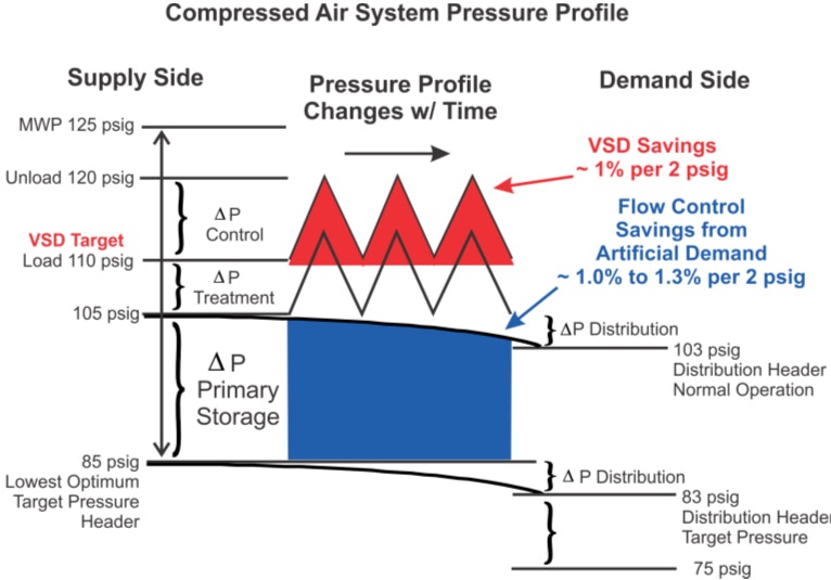

Figure 4. An operating pressure profile displays the important factors in an integrated manner.

A compressor’s part-load efficiency depends on the width of the pressure band and the storage volume. In general, the wider the pressure band, the more efficiently the compressor will operate. However, the wide band causes higher average compressor discharge pressure, which increases energy use.
Lower average supply side pressure can be achieved using VSD compressor control, if the load/unload compressor operates at a constant set target pressure near its load point. The red shaded area in Figure 4 represents the VSD energy savings achieved by operating at a constant 110-psig target with VSD control, rather than using a 10-psi wide load/unload pressure band.
Rather than setting the demand side pressure 20 psig higher than the system’s lowest optimum target pressure, pressure/flow controls can allow reduced demand side pressure and achieve artificial demand savings of between 1% and 1.3% per 2-psi reduction. These savings are represented as the blue shaded area in Figure 4.
