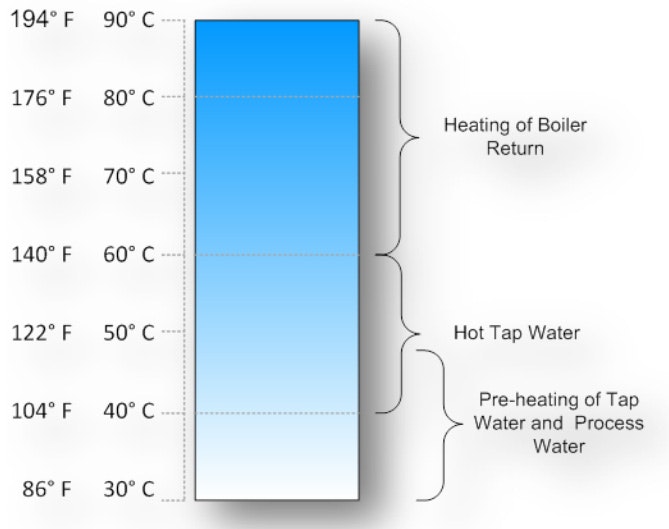

Figure 3. Water heated at various temperatures can have different uses. (Source: Draw Professional Services)
Figure 3 illustrates some typical applications for energy recovery available from the compressor cooling water in different temperature ranges. In the highest temperature level (from oil-free compressors) the degree of recovery is the greatest. The highest efficiency is generally obtained from water-cooled installations in which the compressor discharge cooling water can be connected directly to a continuous process heating system — for example, the heating boilers return circuit. Surplus energy then can be effectively used year-round. Most new compressors from the major suppliers can be adapted to or be supplemented with standard heat recovery equipment. In many cases the degree of heat recovery can exceed 90% if the energy captured can be used efficiently. The function of the cooling system, the distance to the point of consumption and the degree and continuity of the heat requirement are some of the decisive factors.
Energy recovery from compressed air installations doesn’t always result in heat being available exactly when it’s required and sometimes not in sufficient quantities. The instantaneous intensity of recovered energy can vary if the compressor has a variable load. The heat energy demand must be insensitive to these variations if recovery is to be feasible.
Figure 4. Compressor waste heat can be used to heat tap water, boilers or radiators. (Source: Atlas Copco)
The recovered waste heat energy can be best used to supplement the energy supplied by a primary system, such as process boilers or hot water systems that run all the time (Figure 4). This ensures the available waste energy is always used when the compressor is operating.
