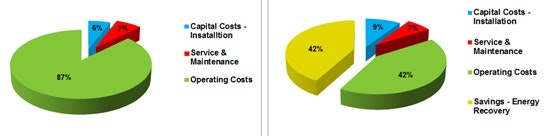

The example below illustrates a typical economic evaluation of a compressor installation, and most importantly, shows the difference between an installation with energy recovery and without energy recovery.
Figure 1. LCC comparison between an installation without energy recovery (left), and a system
with energy recovery (right).

Figure 3 is a simple 10-year LCC calculation with no additional energy savings master controls or energy recovery equipment. In contrast, Figure 4 shows the same LCC calculation, now with energy savings equipment taken into consideration. Although the initial equipment cost is higher than in the calculation without energy recovery, the energy savings difference is significant. The savings shown is $4,540,847 over 10 years. This will be considered life cycle profit because it significantly lowers the 10-year LCC energy cost calculation. The other positive factor in this scenario is the initial savings for the first two years. Savings of $1,189,645 yields a payback and ROI in less than two years (1.7 years).
Figure 4. LCC calculation chart for new compressed air system with calculated return on investment (ROI), energy efficiency improvements and energy recovery values.
