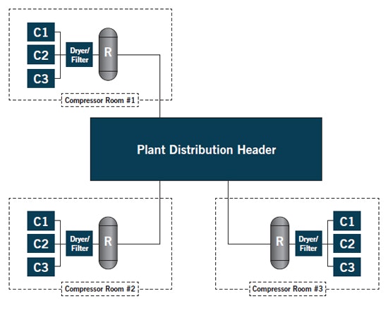

Multiple compressor rooms
If more compressors come into the picture – perhaps as with multiple compressor locations in a system set up like Figure 2 – then the problems multiply. Each compressor room would have different loading conditions and different pressure differentials. The plant distribution header might have a different pressure on one end than the other. But to control the system efficiently, the compressors in one room must be properly coordinated with the other rooms. To properly coordinate the air compressors with local compressor set-point adjustment, a very wide pressure band would be required. In systems with widely varying loads, this coordination is pretty much impossible unless the compressors somehow share the load with the units running at partial loads.
Figure 2: A complex system can be almost impossible to control manually (Source: Compressed Air Challenge)
Part loading is inefficient
One incorrect strategy that might be employed would be to set all the compressors to the same pressure setting so they all share the load. All the compressors would maintain the system pressure within the same pressure band and would share the system load. This may be simple to accomplish but it comes at a huge energy penalty. A typical fixed-speed rotary screw compressor is the most efficient a full load (or turned off).
Running a compressor say at 30% load might consume about 60 to 80 % of full load power. Running three compressors all at 30% load may consume twice what one fully loaded compressor would consume while feeding the total flow. Implement this strategy with nine compressors and the energy bill goes through the roof.
In any system, the optimal control strategy should be to keep all compressors except one fully loaded. The compressor that takes the partial load (called the trim compressor) would be selected by assessing which compressor has the best part load efficiency (load/unload, VSD or variable capacity control. Perhaps this decision could be made automatically.
Moving the sensing point and automating control
To accomplish optimized control the pressure the compressors are using to control the pressure must be consolidated to one common value.  Attempting to accomplish optimal compressor control based on different varying pressure differentials that change over time is just an exercise in futility.  The first step in accomplishing optimal control is to ensure all the compressors in a system are “seeing” the same pressure.  For example, in Figure 1 we would want the compressors to control the pressure at point P3, or if practical P4.  Further to this, if there are multiple compressors in multiple compressor rooms, some kind of sensing and automation system that controls the pressure from a central pressure point in the system would be desired.  This type of control usually involves system master controls that would orchestrate system wide compressor control based on one or more critical system pressure points.
Figure 3: Typical cascaded control (Source: Compressed Air Challenge)
Figure 3 shows a typical cascaded pressure strategy that would ensure that all the compressors except one unit will be running at full load. You can imagine if there were nine compressors to control, you might run out of pressure range at the top and bottom end of the band. Figure 4 shows the typical single pressure band that might be applied using system master controls.  With this strategy, the pressure band remains the same with any number of compressors. Control would add a compressor if the pressure fell below the lower set point and remove a compressor should the pressure go high. If one or more VSD-controlled compressors were employed in the system, the controllers typically would set the target pressure midway between the load pressure and the unload pressure.
Figure 4: Typical single-point control (Source: Compressed Air Challenge)
Beyond promising optimal compressor control, some of today's master control systems also perform other functions, such as controlling auxiliary systems and doing system energy reporting. These systems will get only more sophisticated and adaptable as time goes on. Currently, however, almost all perform the basic system control just described: keeping all required compressors fully loaded except one trim unit. The other compressors are turned off, minimizing unloaded run time and improving system efficiency.
