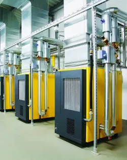

Ducting and tapping into the fluid circuit of compressors is an excellent way to utilize a compressor as a heat source and reduce operating costs.

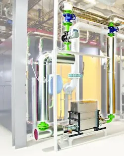

When dealing with existing systems, many compressors can be retrofitted with external heat exchangers for heat recovery.
