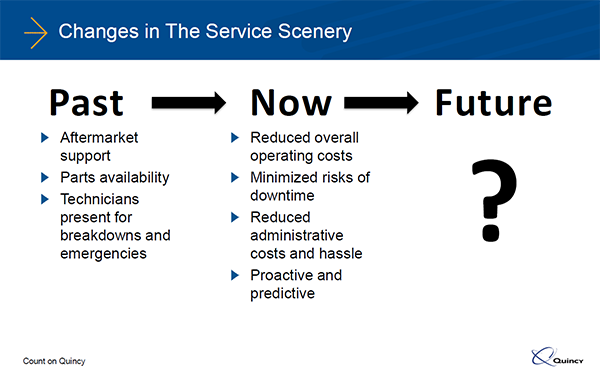

Sometimes technology is changing so dramatically and there is so much more efficiency to be gained from a new piece of equipment that buying new equipment might be the better option. But then again, ask yourself, do I want to have that commitment? The conversations that are being had are around balancing that risk. But now the tone of the conversation changes because I'm no longer having to have that balance. I can choose to replace that piece of equipment and benefit from having additional reliability and higher energy efficiency without having the large capital investment.

TF: If I'm looking at it from the perspective of a customer, then I would be primarily thinking about risk and the level of commitment. How much risk do I have in my business moving forward, and how much am I willing to commit? What if something changes drastically and I no longer need that equipment? From a more positive perspective, what if something changes drastically and I need more equipment or I need more of that equipment? Do I have the ability to modify what I have today and not have high costs associated with it?
That's ultimately what I'm trying to avoid. That would be one of my key factors when considering machine as a service. As I mentioned, it's not something new, we're not reinventing the wheel, but the different options in the market offer different flexibility levels as well.
