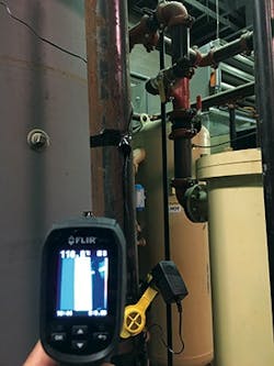

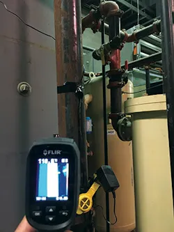

Figure 3. This FLIR camera is detecting abnormally high temperatures on a heated air dryer. Source: Marshall CA

Heat detection
Very often temperature problems cause reliability challenges with air compressors and dryers. These days Infrared (IR) detectors are very affordable and can be used in measuring and tracking critical temperatures. More sophisticated, but affordable, low-cost IR cameras (see Figure 3) are available that give users a complete thermal image of operating equipment. The use of a camera can show how electrical components, compressor coolers, motors, and bearings are performing, all found with a quick glance at a thermal signature.

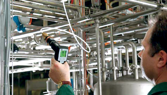

Leak detectors
Another valuable addition to any toolbox is an ultrasonic leak detector. In the past these devices have not been affordable for the average maintenance worker, but now basic units can be purchased for less than $1,000, and at this price level there is really no excuse for not having at least one detector in a plant. Repair of only five cfm of leaks at present day power costs will pay the cost of a basic leak detector in less than a year (see Figure 4).
Ultrasonic leak detectors are very valuable tools to use in reducing waste, and have become more advanced in past years, allowing you to put away your clipboard. There are free smartphone apps that can help you identify and record leakage locations, even storing pictures. Being able to turn off a compressor after a leak repair is the best way to save maintenance costs and save power. Odds are if you don’t have a leak repair program in your plant, you are running too much compressor capacity, or even running out!
Most leak detector suppliers have developed high-end models that have onboard cameras that take pictures of each leak, record location information, and even provide some rough estimation of the leakage flow based on the decibel level. The collected data is uploaded to a cloud database for recording and tracking purposes.
Figure 5. The output of this Fluke ii900 leak detector shows exactly where each leak is located. Source: Fluke
There are now some exciting new cutting-edge leak detectors available that use complicated arrays of microphones to create an acoustical signature overlaid onto a video screen (see Figure 5). This approach gives a very clear picture of the location and size of leaks, something that can be difficult to determine if a leak is not readily accessible. While a bit pricey, this visual type of detection saves time and money and will be the way of the future.
