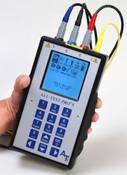

All-Test Pro 5 offers predictive maintenance for electric motor health analysis
The All-Test Pro 5 is a de-energized, non-destructive instrument for electric motor health analysis.
The All-Test Pro 5 is a de-energized, non-destructive instrument for electric motor health analysis. The tool allows users to:
