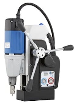

CS Unitec's AutoMAB 350 portable magnetic drill features an automatic feed mechanism
CS Unitec has introduced a new model to their MAB line of portable magnetic drills. The AutoMAB 350 features an automatic feed mechanism with automatic reverse and shut off.
The AutoMAB 350 drills holes up to 1-1/2” dia. with annular cutters in structural steel and other metals. Drilling depth is 2-3/8” max. with a pilot pin and 4-3/8” without a pilot pin. An integrated automatic cooling/lubrication system increases the life of the annular cutters by reducing friction and wear. Designed for continuous use, the drill operates at 450 RPM. The drill’s power feed controls drill pressure to maintain optimal RPM and feed rate.
The AutoMAB 350 is equipped with the SAFEMAG™ System which determines whether the magnet has sufficient adhesive force on the material and alerts the user with LED indicators - green for go, red for stop. The Electronic Safety Shutoff Sensor automatically shuts down the drill motor if the magnet loses contact with the material. Additional safety features include simple arrangement of controls for one-handed operation and LED load indicators.
