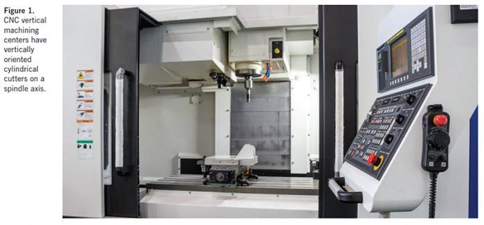

CNC vertical machining centers are regarded as some of the most versatile machinery used by leading manufacturing firms. These machines have vertically oriented cylindrical cutters on a spindle axis (see Figure 1).

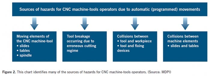

However, CNC machines must only get operated by qualified machinists. Excessive automation often drives employers to recruit minimally skilled labor not trained to perform the tedious tasks when required. This scenario can pose a threat to the operators’ safety and the streamlined functioning of the machine. Automatic or programmed movements can be sources of hazards for CNC machine-tools operators (see Figure 2).
