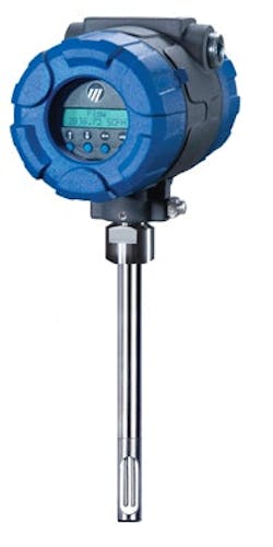

Magnetrol's Thermatel TA2 thermal dispersion mass flow meter features Foundation fieldbus
Magnetrol has announced the release of the Thermatel TA2 thermal dispersion mass flow meter with Foundation fieldbus digital output communications. The flow meter offers plants and other facilities an energy management solution through its measurement of natural gas and compressed air.
The Thermatel TA2 with Foundation fieldbus offers all of the advantages of the standard TA2 model, such as:
- Dual gas calibration with two unique curves (example: propane and natural gas)
- Field adjustability to install in different gas types or adjust for different gas mixes
- Calibration verification procedure provides cost savings due to decreased process downtime and unnecessary recalibrations
- Internal resettable and non-resettable totalizers
- Strong signal at low flows and low pressures with high turndown
- ISO 17025 and NIST traceable calibrations
