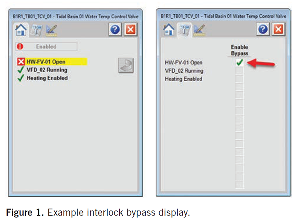

With a modern control system, component failure doesn’t need to bring production to a halt. The network administrator can assign role-based access to maintenance techs, who then have access to additional options such as selectively bypassing some interlocks, as shown in Figure 1. With role-based network privileges, the maintenance tech is able to bypass the specific interlock, allowing production to continue while the tech heads to the stockroom to get the replacement and arrange to make the repair at a suitable time within the production window.
