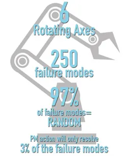

Figure 1. The preventive maintenance you’ve been trying to complete will at best only resolve 3% of the failure modes associated with your robots.
Fifty years later, there are more than 2.4 million robots in use at manufacturing facilities around the world, and, while the robot has proven itself in terms of quality and efficiency, the high-tech solution comes with its own set of problems. Included with the technological advances comes a rather large set of random-based failure modes that can result in extended unplanned outages.
We recently worked with a group of robot experts to perform a reliability-centered maintenance (RCM) analysis of a manufacturing robot that had six rotating axes. In analyzing the equipment and controls, the team identified more than 250 failure modes, 97% of which were random-based (Figure 1). While an RCM purist might find some comfort in these numbers, the average maintenance and operations manager should pause and take note: The preventive maintenance you’ve been trying to complete will at best only resolve 3% of the failure modes associated with your robots.

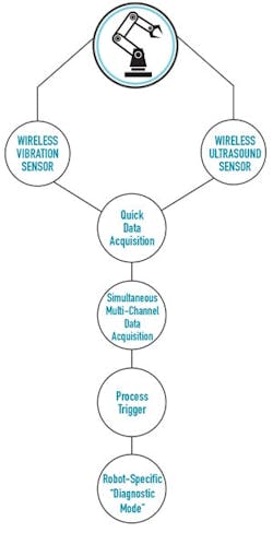

Figure 4. Utilizing high-frequency domain data available with this monitoring solution allows for the earliest possible notification of issues developing, which will allow ample time for proactive initiatives.
High-tech assets require high-tech solutions
We permanently installed sensors in a way that allowed monitoring of the robot on a near continuous basis without interfering with the robot’s performance. The equipment has to work with a wireless transmitter to enable sending information from up to seven sensors on as many robots as the customer wants to analyze (Figure 4).
The result is a system that uses data from vibration monitoring and contact ultrasound and allows the setup of robot/joint-specific analysis parameters and alarm bands based on readings and emissions. Using a wireless vibration monitoring system enables quick data acquisition capabilities. Combine this simultaneous multichannel data acquisition with process triggers and robot-specific, diagnostic-mode operational programming, and you get consistent repeatable data for trending and analysis. Utilizing high-frequency domain data available with this monitoring solution allows for the earliest possible notification of issues developing, which will allow ample time for proactive initiatives. Data from early testing of the system on live robots indicates an on-line solution to detect nearly all of the failure modes associated with the rotating components of a robot.
