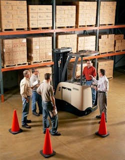

Figure 1. Forklift operator training reduces safety risks and safety violations, in addition to production and maintenance downtime.
Moving materials is a big part of production in any plant, and it doesn’t have to compromise a safe work environment. Plant managers should take a variety of measures to ensure their facilities are as safe as they are efficient. “Conduct weekly safety meetings,” offers Vince Hoy, plant manager at the WestWind Logistics plant in Omaha, Nebraska (Figure 1). “They don’t need to be long, just 5 minutes. I do mine on Monday mornings. It just helps people get in work mode while also implanting safety notions in their heads. Daily reminders, posters, preventive maintenance, and periodic safety spot checks will help keep people diligent while also reminding them of safety.”
Plant managers play a key role in ensuring their facilities are safe and efficient, emphasizes Jonathan Dawley, president of Hyster Distribution (www.hyster.com). “A few areas of which plant managers should be aware and look to implement into their facility are proper equipment maintenance, pre-operational inspections, fork inspections, lift trucks designed with new technologies offering system-controlled functionality, and lift truck operator training,” he says.
Safe forklift operation should be taught and reinforced as an integrated part of a company’s culture, explains Brian Duffy, director of corporate environmental and manufacturing safety at Crown Equipment (www.crown.com). “Plant managers can help foster a culture of safety and ensure that facilities are as safe as they are efficient by implementing a formal training program that allows forklift operators to develop safe habits,” he suggests. “Formal results-based training programs prepare operators to perform tasks safely, reliably and effectively in the workplace by practicing their skills and receiving feedback from managers who can help them develop safe habits. Safe forklift operation isn’t something that can be practiced once and then neglected. Plant managers must set the expectation and then help employees to develop good habits and demonstrate safe performance on a daily basis.”
