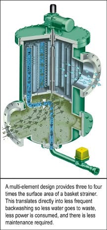

Water strainers for mass raw water filtration have been around for decades, and today manufacturers offer a variety of designs, including those that operate automatically. One of the more significant advances in strainer design occurred in the 1960s when the first multi-element, automatic self-cleaning strainer design was developed.
This strainer design was particularly significant because it provided a durable and reliable alternative to the classic basket-type strainer that — although it sometimes carries a lower price tag — also is limited by its strainer surface area, which can quickly become clogged and force excessive cleaning cycles (backwashing) and reduced water for process requirements.
By replacing the basket with multiple tubular elements, the design provides three to four times the straining surface area of a typical basket strainer. As a result, debris and solids — including from seasonal peaks — are efficiently removed without downtime. The increased surface area of the multi-element design allows for fewer backwashes, equating to lower operational costs, less maintenance and greater overall efficiency.

Another significant feature of the multi-element design is in the engineering of the backwash mechanism. With basket strainers, the backwash mechanism comes into direct contact with the straining media. This can be problematic because large, suspended solids often encountered with raw water can become lodged between the straining media and the backwash arm. The result is straining media damage and/or rupture that can compromise plant operations.
The multi-element design utilizes a tube sheet to separate the straining media from the backwash mechanism. This prevents the backwash mechanism from coming into contact with the media and damaging the elements caused by large solids becoming lodged between the media and the backwash arm.
Furthermore, the multi-element design provides three to four times the surface area of a basket strainer. This translates directly into less frequent backwashing, so less water goes to waste, less power is consumed and there is less maintenance required. Partington’s decision was also due to the fact that these strainers could provide the necessary plant water requirements even while in backwash mode.
