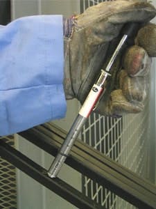

Advanced tools include a thermal imager and vibration analyzer. Some inexpensive tools you might want to add to your arsenal include groove gauges to check for sheave and belt wear (Figure 2), a belt-tension gauge (Figure 3) and the belt vendor’s preventive maintenance manual. These are available from your belt vendor, who will show you how to use them. Preventive maintenance manuals, your primary guide for maintaining and troubleshooting belt drives, might be available on the belt manufacturer’s Web site. The manual should provide generalized tension recommendations and lead you though the troubleshooting process.
Figure 2. Use a groove gauge to help visualize sheave wear.
Figure 3. The tension gauge should be used for proper drive tensioning.
