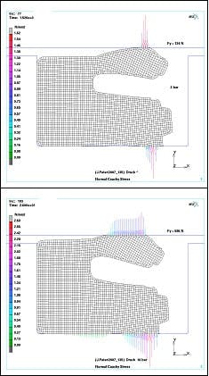

Piston seal: U-cup-type piston seals have been used in pneumatic cylinders for many years. The design in Figure 2 has several special features. It has a thin connection between sealing lip and body to achieve low radial force. Toward the contact area, the lip is larger to give stability under pressure.
Figure 2. This piston seal provides stability in the contact area and minimizes radial forces that can affect cylinder movement.
Notches at both lips and on the outer diameter of the back side avoid malfunctions. The notches on the side of the outer sealing lip ensure proper activation when the pressure increases. Notches at the outer diameter of the back (not shown in Figure 2) and on the inner lip act as pressure-release channels in case pressure is trapped between the two U-cups in a double-acting piston. Without these notches, a pressure trap, together with friction, can tilt the seal in the groove, which results in an inoperable cylinder. The rounded contact area of the sealing lip was optimized by finite element analysis to ensure good function over the whole pressure range (Figure 3).
Figure 3: Finite element analysis result of the lip seal reveal its performance at 29 psi and 145 psi.
A polyurethane material was developed for the specific demands of pneumatic applications. The 83 Shore A hardness is relatively low to minimize the radial force. With its good compression set, low friction and extraordinary wear resistance, it provides the preconditions for good functional properties and long service life.
