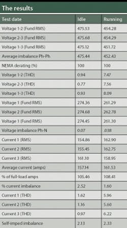

Table 1
Test results with the winder down and with it running.

Initial test data on a another motor indicated the voltage harmonics were greater than 5% and full load amps were at 107%. We researched the power distribution system to the motor control center to try to identify what might be causing the harmonics. A 13.8-KV, 2,500-KVA transformer was the feed for the motor control center’s 460-volt service handling eight motor lineups and five DC drives. The other DC drive power transformers in the plant supply power only to the DC drives and aren’t used in combination with AC motors. This suggested the DC drives might be generating the power-quality problems.
We ran further testing to compare the results when the winder wasn’t running and when it was. As shown in Table 12, when the winder wasn’t running, current harmonics (THD) were less than 2%, voltage harmonics were less than 1%, full load current was 105% of rated current, and the system voltage was 475 volts. With the winder running, current harmonics (THD) were greater than 5%, voltage harmonics exceeded 7%, full load current was 108% of rated current and a system voltage drop was 21 volts. These power-quality problems were reported to the appropriate department managers and then filed away.
A new microprocessor-based dock lock system for their eight-bay loading dock had been purchased and the electrical supervisor’s crew had installed a new power feed for the controllers. The vendor installed the lock system and it was under warranty. It worked fine most of the time, but sometimes the locks would open and close spontaneously. The controller manufacturer’s field service group (including their design engineer) had made several trips to investigate. They replaced several electronic cards and two complete controllers. The supervisor’s crew took the power for the new feed from the motor control center in question.
The electrical supervisor remembered the power quality report and wondered if the power quality issues might still be on the supply from the motor control center. After reviewing the report, the electrical crew installed line filters on the new controllers. The dock lock controller problem disappeared.
