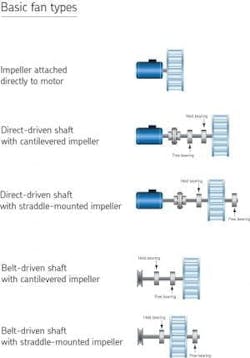

1. Get oriented
One cause of fan failure is confusing the fixed and floating bearing positions. A typical fan has two bearings supporting the shaft. In most cases, the bearing exposed to the highest radial load should be fixed, or axially held, within the housing. Radial bearings generally perform better when the axial-to-radial load ratio is low.
Also, the axial force needed to float a bearing is lower when the radial load is lower (axial force to move bearing = coefficient of sliding friction x radial load) (or Fa = µ x Fr). The fan’s other bearing should be allowed to float internally or within the housing bore, thus accommodating shaft expansion and contraction.
In most fan applications, the bearing closest to the motor or belt drive has the highest radial load and should be the fixed bearing. This is the case in most of the common centrifugal fan arrangements - overhung belt-driven, center-hung belt-driven, and center-hung direct-driven fans. Figure 1 shows the motor, bearing and rotor locations in common centrifugal fan arrangements.
Overhung direct-driven fans are an exception to the rule. Here, the bearing close to the motor is nearly unloaded and should be allowed to float. The bearing farther away from the drive handles the heavier radial load and should be fixed in the housing.
Another case in which it might not be appropriate to fix the most heavily loaded bearing is when the fan rotor has a very tight clearance with surrounding structure (typically the inlet cone) in an overhung fan arrangement. Here, it’s sometimes necessary to fix the rotor side bearing so that thermal expansion and contraction of the shaft doesn’t cause the rotor to rub.
