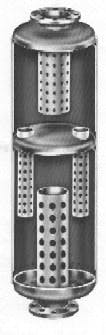

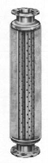

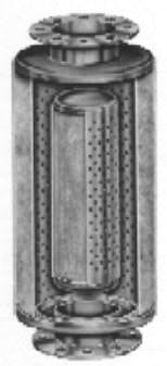

Several simple techniques can attenuate noise at the compressor. Install a muffler or silencer on the inlet (Figure 3). Device selection must consider its effect on compressor operation, available space and noise characteristics.
Treat high-frequency inlet noise with a simple absorptive muffler. These have a straight perforated pipe through a housing stuffed with fibrous media. You might have used a similar “glass-pack” muffler on your car to achieve that muscle car sound.
The absorptive muffler has a low-pressure drop and can be used at an open inlet unit with a filter or in-line if low-pressure air is being piped from a remote source. Some combination filter-silencer products may be available from filter manufacturers.
Figure 3. Pick a muffler
Use absorptive mufflers (left two) for high-frequency noise. Consider expansionchamber or reactive mufflers (right two) for low frequencies. Low-frequency inlet noise can be treated with an expansion chamber muffler, but at the expense of much greater pressure drop. The expansion chamber, or reactive muffler, is a housing with two or more empty chambers connected by short segments of perforated tube, similar in design to the standard auto muffler.
