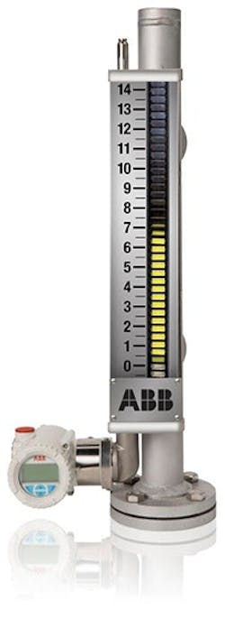

ABB has announced the release of its next generation of magnetostrictive liquid level transmitters that are designed to improve level measurement for a wide variety of applications. The LMT Series of magnetostrictive level transmitters' principle of operation and simple setup ensure that total and/or interface levels are always measured reliably and accurately, minimizing downtime and maximizing process efficiency and operating profits. Key features include:
  • Certified to Safety integrity level 2 (SIL2) and systematic capability 3 (SC3) according to IEC61508 and can be used in applications area of IEC61511-1 up to SIL-2(HFT=0) and SIL3(HFT=1)
  • High accuracy: 0.01% of full scale or ± 1.27mm for total level and/or interface measurement with superior patented AccuTrack Sensor technology
  • HART 7 digital communication and 4 to 20mA analog output
  • First magnetostrictive level transmitter with Through The Glass (TTG) touch screen interface and Integrated and Interactive Waveform
  • RoHS 2.0 and NAMUR standards with global Hazloc ATEX/IECEx, cFMus, NEPSI, CRN approvals
