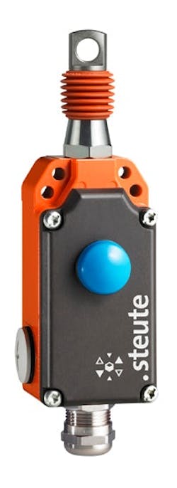

STEUTE's Series ZS 71 emergency pull wire switch is IP 69K rated
STEUTE's Series ZS 71 emergency pull wire switch is equipped with snap-action, NC positive-break contacts, providing a safe, reliable means for initiating an emergency stop along the length of the installed pull-wire.
April 17, 2018
STEUTE's Series ZS 71 emergency pull wire switch is equipped with snap-action, NC positive-break contacts, providing a safe, reliable means for initiating an emergency stop along the length of the installed pull-wire. Switching function occurs if actuating wire is pulled or breaks. Its' 35 meter reach, integral pushbutton reset; rugged, die-cast aluminum, powder-coated housing; and IP 69K ingress protection rating, make it suitable for a wide range of applications.
