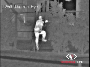

Developments in video and infrared (IR) cameras are making it possible to monitor remote areas of the plant and remote sites, such as electrical distribution systems and transformers. You are probably familiar with using infrared cameras to detect maintenance problems on motors, electrical boxes and insulation. Similar devices can be used to detect intruders, day or night.
“The newest generation of systems combines visual and IR cameras with airborne ultrasound detection,” says Jon Chynoweth, director of marketing at Mikron Infrared (www.mikron.com). “The infrared and visual images can be blended and transmitted to a PC via wireless, enabling clearer, faster identification and pinpointing of both physical incursions and thermal anomolies at remote sites.” In other words, you can use the same camera to detect remote maintenance problems and intruders.
When the Barclay Group (www.barclaygroup.us), a security consultant in Anderson, Ind., upgraded the surveillance systems for a major energy company, it had to provide real-time video monitoring on a 24-hour basis around the perimeter of a power generation plant. The problem was how to get images under poor light conditions. “Although many of today’s cameras can get some video signal from dark areas, it usually is not enough,” says Mark Barclay, president. “For Homeland Security projects, it’s necessary to deliver the best picture possible and for that, you need to use IR cameras and IR lighting.”
Infrared lighting is used more in Europe than here, but it is catching on. IR lighting involves illuminating a scene with invisible light of a slightly longer wavelength than visible light. Intruders can’t see it, but IR-sensitive cameras can use it to take high-resolution video images that resemble normal black and white images taken during the day.
It’s not always necessary to use IR lighting. Thermal-Eye (www.thermal-eye.com), a manufacturer of infrared cameras, says it can spot intruders in complete darkness (Figure 2). In some installations, it integrates its cameras with an existing CCTV network so security personnel can see remote areas night and day. At night, it comes down to deciding whether you need high resolution to identify an intruder or just to detect the intrusion.
Spot intruders
Figure 2: Infrared cameras can spot intruders in complete darkness.
