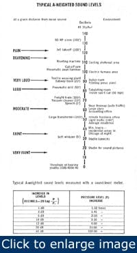

Figure 1. Typical A-weighted sound levels correlate with various activities and noise sources.
To understand what causes noise and how to minimize it, one must first understand the basics of sound. The audible frequency range falls between 20 Hz and 20,000 Hz. However, the human ear has trouble hearing frequencies much below 200 Hz or above 10,000 Hz. Although humans’ hearing frequency range might be limited, the ear can distinguish a range of pressure fluctuation from very low levels to very high levels, which gives the ear an increased sensitivity of about 10^-9 power or one billionth. Because of the large values that characterize this high sensitivity, a decibel (dB) is used to define sound levels. Figure 1 provides a table of common decibel levels and relates them to sounds with which most people are familiar.
