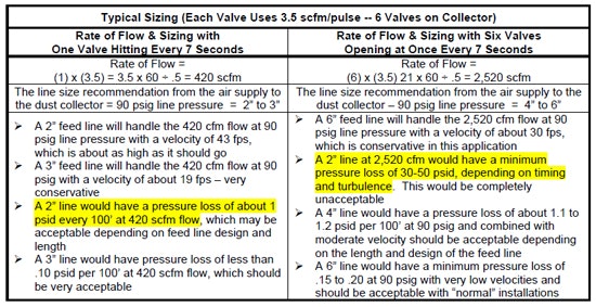

Flow rate is the average flow of compressed air in ft3/min either required by a process or delivered to the system. Rate of flow is the actual rate of flow of compressed air demand expressed in ft3/min, regardless of duration. Even relatively small air demands in ft3 can have a very high rate of flow, if they occur over a very short time period. Dust collectors have this characteristic.
Sequence controllers can have a very significant impact on the required rate of flow. For example, pictured below is a dust collector system which has six pulsing valves that use 3.5 ft3 over a half-second for each pulse. When this is a problem, appropriate storage and piping can be a very effective correction when properly implemented (Table 1 and Table 2).
Table 1.
Table2.
 The impact of two different rates of flow would show similar differences in regulator sizing if they are used on the feed line flow. The high flow velocities entering the manifold and controls for the pulse valves will create extra pressure loss through the nozzle, affecting the performance of the pulse cleaner. The same effect would show up in air receiver sizing to minimize system and feed line pressure drop if that is a question (Figure 1).

We recommend that every feed line has a quality pressure gauge installed near the dust collector entry. Observe the pressure gauge when the pulser hits. If the pressure drop is too high (more than 10-20 psig), start looking for the cause. Record the specifications on the dust collector (cfm per pulse, feed line pressure, time per pulse, cycle time between pulses). Calculate the rate of flow, and check line size and storage. If additional storage is required, it can be calculated by using the previous formula.
