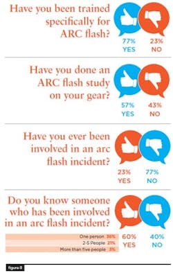

The survey also asked four specific questions on arc flash training and incidents; all are captured in Figure 8. It’s interesting to note that ARC flash studies are performed on gear far less often than training on ARC flash is provided to respondents; as one respondent mentioned earlier, budgetary constraints may play a role here.
For this first Electrical Safety survey, we also added two questions on whether you (23%) or someone you know (60%) has been involved in an arc flash incident, and these data also are reported in Figure 8. However, as one respondent noted, both of these questions would deliver more insight if further options were available for respondents to select beyond “yes” and “no”; for example, these options could include whether or not the incident involved people, or people but no injuries, or incidents with lost time.
