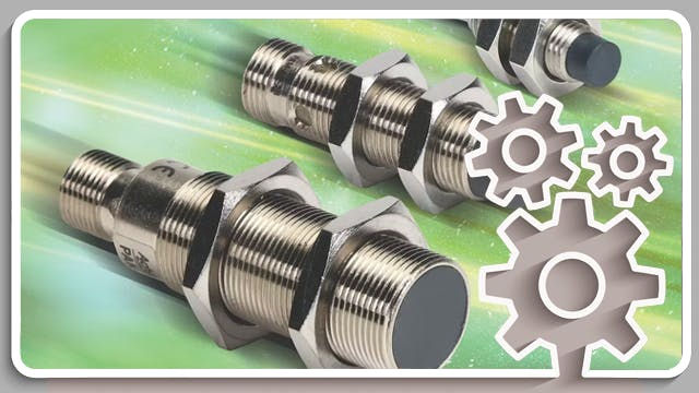

AutomationDirect's AchieVe series value line of inductive proximity sensors
AutomationDirect has added its value line of AchieVe series of inductive proximity sensors. These tubular inductive proximity sensors made from stainless steel are offered in 8, 12, and 18-mm barrel sizes. Flush and non-flush mount styles offer a range of sensing distances up to 8 mm. Both PNP and NPN logic models are available, and all have a NO output. Connection options include an M12 Q/D connector for 12 and 18-mm models, an M8 Q/D connector for 8-mm models, and a 2-m pigtail cable style available for select PNP logic models. Learn more about the product
