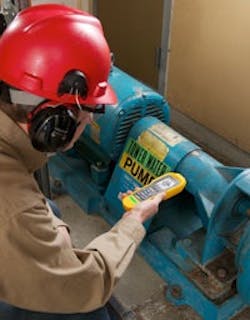

The handheld Fluke 805 FC measures overall vibration from 10 to 1,000 Hz and provides a four-level severity assessment for overall vibration and bearing condition. It detects peaks in the vibration signal readings of roller bearings from 4,000 Hz to 20,000 Hz, and uses a proprietary algorithm to interpret severity to determine if the bearing is going bad. And it features an infrared sensor that automatically measures surface temperature and displays it along with the vibration reading for a broader understanding of machine health.
The 805 FC has a unique sensor tip design that minimizes measurement variations caused by device angle or contact pressure. This reduces operator error and improves the accuracy and repeatability of quick vibration screening. The meter also provides a severity scale for both overall vibration and bearing condition readings, delivering more information than typical vibration pens.
