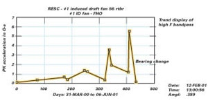

Vibration spectrum trended over time. This shows before and after the bearing was changed.

Trend data from an alarm band
The databases are constructed in a tree type fashion.  The database is divided into routes, which are, in turn, delivered to specific machines. The machines receive multiple monitor points, with each monitor divided into multiple analysis parameters. The number of parameters available depends on the software package, but it’s usually between six and 12.  Each analysis parameter has a frequency range based on specified fault requirements. They also are given an alarm and alert value.
