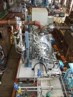

Large multistage process pump on test at Dengyosha Machine Works in Tokyo, Japan (or “Statistically, 7% of one’s equipment population devours 60% of available funds.”) Source: Heinz Bloch
