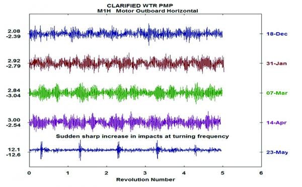

The waveform data collected from the motor opposite drive end in the horizontal orientation, both velocity (Figure 3) and PeakVue (Figure 4), had reached excessive amplitudes of vibration. Based on these data, it was recommended that the alignment, belts, and sheaves be inspected and repairs made as needed.
Figure 3. Time waveform data (for velocity) spectrum collected from motor opposite drive end in the horizontal orientation (Dec. 2013 – May 2014).
Figure 4. Peak waveform data (PeakVue) collected from motor opposite drive end in the horizontal orientation (Dec. 2013 – May 2014).
Two months later, complaints were made that the same machine was running roughly. The complaints were reported just prior to regular monthly route vibration data collection. Due to the continuing nature of the complaint, the data setup was examined, and the data resolution for that machine was significantly increased.
