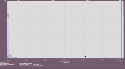

Vibrations were excessive from the motor opposite drive end. As can be seen in the spectrum, the harmonics of ball pass outer race (BPOR) frequency were present (Figure 1).
Figure 1. Vibrations were excessive from the motor opposite drive end. As can be seen in the spectrum, the harmonics of ball pass outer race frequency were present.

A confirmation vibration report was assembled with spectrum identifying the motor opposite drive end bearing had an outer race fault.
Motor repair was completed on a holiday when cooling load was at its minimum.
Figure 2. The spectrum after completed repair and bearing harmonics have been eliminated confirms acceptance.
Another set of vibration readings were taken to confirm acceptance of completed repair work. Figure 2 is the spectrum after completed repair and bearing harmonics have been eliminated.
