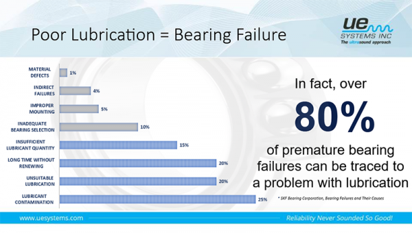

PS: Do you need to set a baseline decibel level in order to start a bearing lubrication program with ultrasound?
AM: No, you don't. I talked a lot about establishing baselines, and that really is the point where you'd like to eventually get. I know just starting out, you have to think, “We haven't currently been monitoring these assets, so how do I know if what I'm listening to is good or bad?”
One of the quickest ways to get a handle as to what's good and what's bad is just by simply doing a comparison. We compare decibel level readings on identical points on identical machines, and that'll give us a really good, quick indicator as to what's good and what's bad.
When it comes to setting baselines, the first reading that you take and download, the software will set that reading as the baseline. But we really recommend a more “historical approach” where we establish an initial trend.
Let's say when we first set up our route, we want to go out and take a reading once a week for a month. So we take four or five good readings, and then at that point, we can set any of those readings as our baseline. It's very easy to change the baseline from one reading to the next.
It would also be a good practice to take a grease gun out with you so when taking those initial readings. If there are any points along that route to where the decibel level fails as we applied grease, that would be a really good reading to take and use as the baseline because that bearing was already in need of lubrication.
