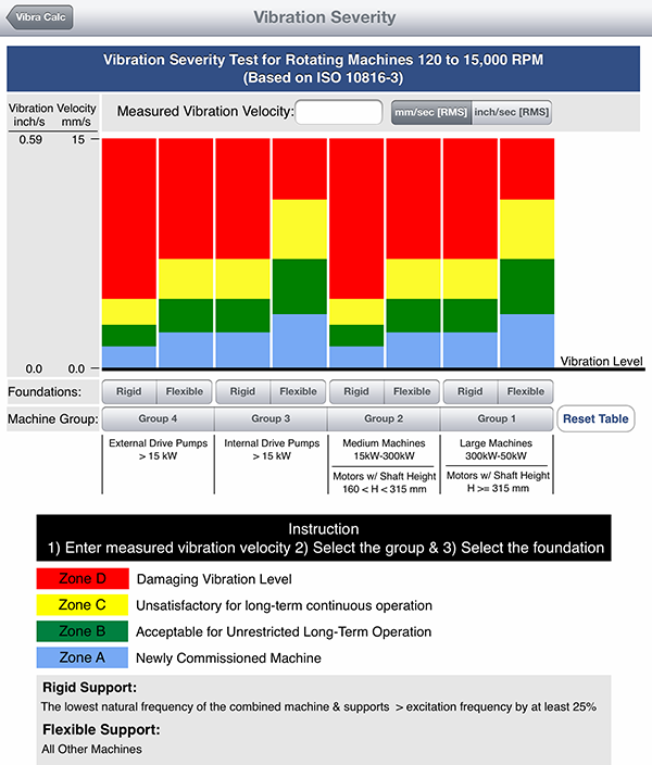

The next step is to set alert and alarm levels for each asset using ISO standards to see when an asset exceeds recommended vibration levels.
