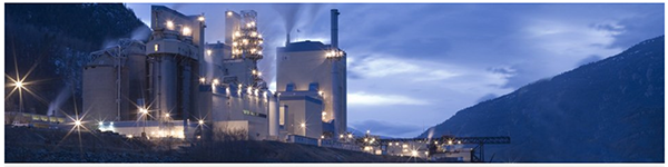

Mercer Celgar, a modern pulp mill located in British Columbia, Canada, is targeting zero unpredictable failures on all rotating equipment in its PdM program (2,381 total), and has plans to transition from the existing automated diagnostic system to ML in 2021.
