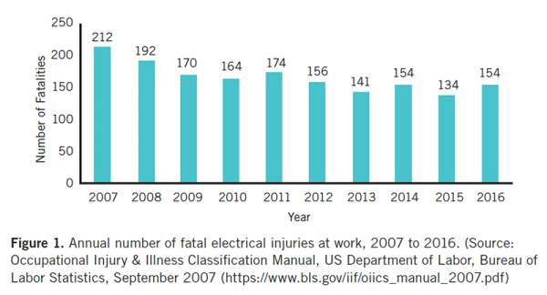

According to research by the National Fire Protection Agency (NFPA), from 2012 to 2016, a total of 739 workers died from exposure to electricity. Eighty percent of the fatal injuries were from direct exposure to electricity while performing construction, maintenance, or cleaning activities. The majority of the locations where the fatalities happened were industrial facilities. Although the numbers of fatal injuries are still high, the numbers have trended downwards over the last 10 years (see Figure 1).
